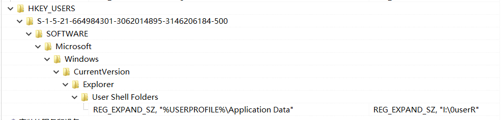

Ok. Finally, I still modified the application data directory of the system
