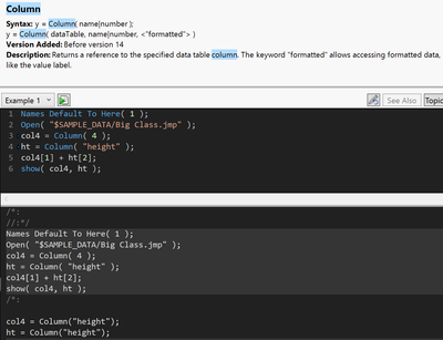

Have you investigated the column() function? Instead of using a column name, you can use it's index.  This could be useful in a for() loop.
