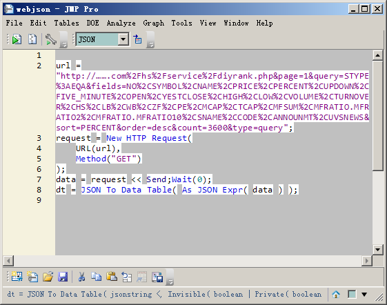

Instead, I simply used the JSL code that downloaded the web data using JMP and added a later line of converted code.Please continue to guide me, thank you!
lwx228
Level VIII
Re: How can arrange JSON into a table using JSL?
I wrote it this way.
url = "http://……";
request = New HTTP Request(
	URL(url),
	Method("GET")
data = request << Send;Wait(0);
dt = JSON To Data Table( As JSON Expr( data ) );
