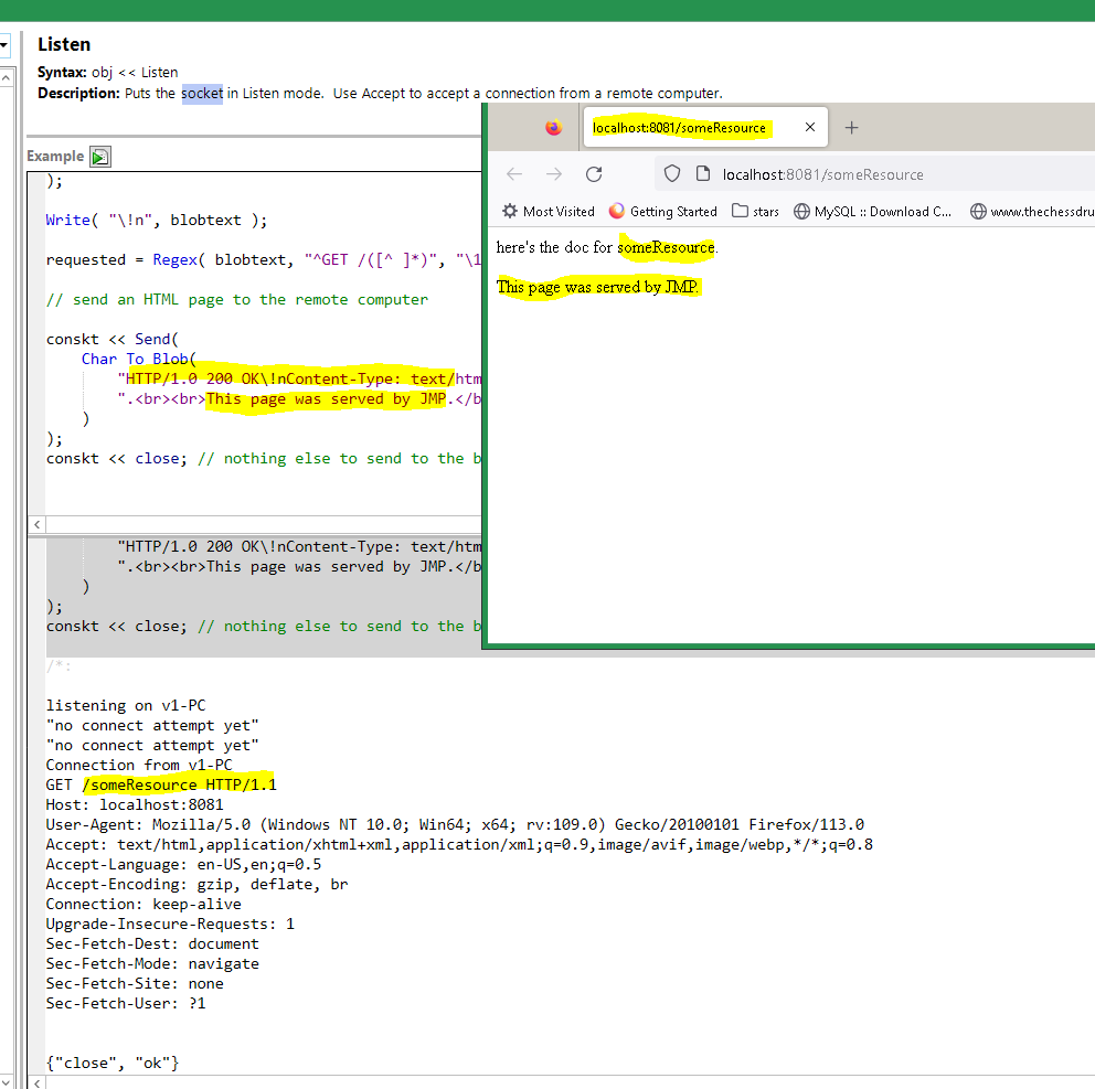

Re: How can I listen for HTTP requests and then fire a callback function?
You could use JMP's HTTP Request to ping the Flask server. That would remove a level of complexity of what you are wanting to do.
You can query the server with HTTP Requests (I assume a GET operation) and read the response directly with the return (like a JSON payload) and then when it's ready, use HTTP Request again (probably as a GET) and process the data from the server. Of course, if you are using sockets, rather than HTTP/HTTPS, then you'll want to stick with your socket approach.
Craige_Hales
Also, JMP's sockets do not support https, only http. They are fairly thin wrappers around low-level socket code and know nothing about http protocol: you have to build it all yourself. There is a complete example in the scripting index:
The "listen" example is self-contained.The "listen" example is self-contained.
It is quite difficult to build a web server in JSL. If you are already using Python from JMP, take a look at Project file for Jelly Video especially the NumberServer. I needed to run multiple copies of JMP to produce the images in the video and I needed a way to hand them the work they needed to do. The number server did that, and provided the instrumentation for a JSL dashboard so I could tell when something needed attention. (That python server was single threaded, I think, which turned out to be a good thing for serving up unique numbers for simultaneous requests. At least I never noticed a duplicate...)
Craige
Craige_Hales
On re-reading, I agree with Bryan: you should be using http request to talk to the flask server.
Apparently flask and websockets are good friends too: https://blog.miguelgrinberg.com/post/add-a-websocket-route-to-your-flask-2-x-application
See WebSocket  for an example; a websocket is a bi-directional connection that just stays open...forever...receiving driblets as they come in. It makes a browser accept pushes from a server without polling. That example code uses the Python websocket and JMP's RunProgram to avoid blocking issues.
Craige
