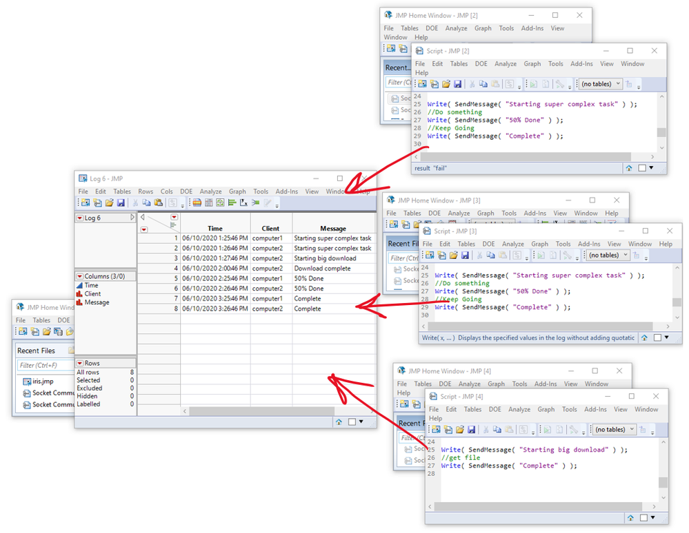

It is sometimes useful to collect messages or data in a central location from long running scripts, or scripts running on remote computers.  Attached are four files that demonstrate this:
  1. A 'server' which collects messages from other machines or processes and puts them in a data table. Run this in a separate instance of JMP from any other scripts or tables.
  2. A 'client' JSL script which sends messages to the server, embed this in scripts.
  3. A 'client' R script which sends messages to the server
  4. A 'client' python script which sends messages to the server
Here is an example of how this could look, the clients on the right can be on different computers, or separate copies of JMP on the same computer.
