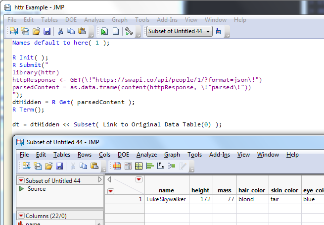

Re: Detailed Guidance on Using JSL to get data from API
My go-to is the httr package in R.  It has very mature get/request and parsing capabilities, including json.  The documentation is good and there are a lot of examples out there.  Once installed this is all it takes to get data into JMP from the first API I could find that didn't need login info:
Names default to here( 1 );
R Init( );
R Submit("
library(httr)
httpResponse <- GET(\!"https://swapi.co/api/people/1/?format=json\!")
parsedContent = as.data.frame(content(httpResponse, \!"parsed\!"))
dtHidden = R Get( parsedContent );
R Term();
dt = dtHidden << Subset( Link to Original Data Table(0) );
