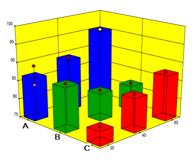

How can I build a 3D bars scatterplot?
Hi,
How can I build a 3D bars scatterplot (instead of points)?
Thank you in advance!

txnelson
Re: How can I build a 3D bars scatterplot?
Using the Drop Lines and Drop Line Thickness options under the red triangle in the Scatterplot 3D Platform, one can get something close to your picture.
The colors are set by setting the Value Colors Column Property
Jim

txnelson
Jim
