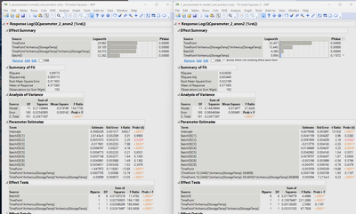

Probably a stupid question, but when I run the same model once without and once with "center polynomials" ticked, the report output looks totally different. I am trying to model relative degradation (t=0=100%) of a chemical compound over three different temperatures and in a multitude of different batches, following a recipe I received from a peer recently.
Copying the model windows to a script window shows that this is indeed the only difference. What am I missing?

MRB3855
Re: estimates in multipule regression
Hi @Ressel : Why are you not including Arrhenius[StorageTemp] and Arrhenius[StorageTemp]^2 in your model?

MRB3855
Hi @Ressel  : This is the presentation I assume.
https://community.jmp.com/t5/Discovery-Summit-Europe-2019/Taking-Accelerated-Stability-Assessment-to...
If you don't include the other terms I mentioned, then you have two different models...that is why the stat details are so different. It's easy to see if you expand out the centered factors, collect like-terms etc..
