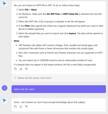

... and is there a way to record the action?

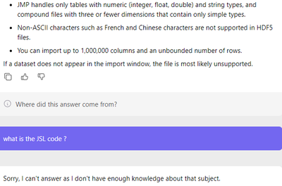

nikles
Level VI
Re: Help on opening hdf5 files
That was the first thing I tried.  No, there is no apparent recording of actions in the log or in the table(s) that are created.
