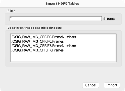

I'm trying to use JMP to open a hdf5 file using a script.  I can successfully open it using the Open() command:
blobpath = "/Documents/myblob";
dtblob_lis = Open(blobpath);
but I get a pop-up asking which data set I'd like to open:
My question: is there an option in the Open() command I could use to specify which data set within the blob I wish to open, and avoid the pop-up?  Thanks.

There is an example of this at https://www.jmp.com/support/help/en/18.1/index.shtml#page/jmp/import-data.shtml under the section "Import HDF5 Files".  Admittedly a bit challenging to find, but it does show up in Google.
Brian
nikles
Level VI
Re: Help on opening hdf5 files
This is exactly the solution I was looking for.  Works.  Thanks.
