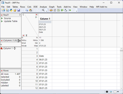

bonjour,
je n'arrive pas à avoir le bon format dans JMP (d/m/y) comme dans excel et après plusieurs essais, j'ai toujours dans JMP: m/d/y.
merci pour votre aide

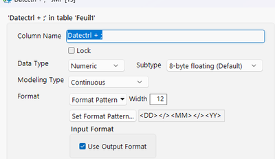

// Modifier les informations de colonne : Datectrl + ;
Data Table( "Feuil1" ):"Datectrl + ;"n <<
Set Data Type(
	Numeric,
	Format( "Format Pattern", "<DD>/<MM>/<YYYY>", 10 ),
	Input Format( "Format Pattern", "<DD>/<MM>/<YYYY>" )
) << Set Modeling Type( "Continuous" ) << Set Field Width( 12 );

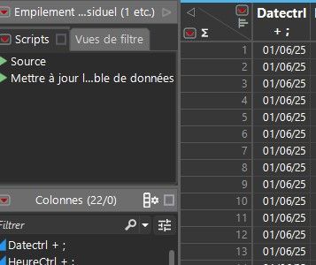

Re: probleme import date excel
surprising, which version of JMP?
I tried it with JMP18 and JMP19 and without adjusting a setting I got:
Maybe a wrong setting in the (system) preferences?

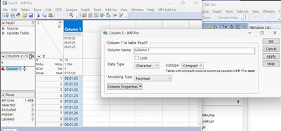

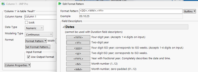

Disable "Limit column type detection" so you get your data as character to your JMP table in this case (from this you can more easily set the format as you wish).
Then you can remove extra rows (could be done in import just make sure you still have character data). From this you can start then fixing the format
Generally, Format Pattern is the best way of formatting your character data into dates.
After the data has been correctly formatted into JMP number, you can then change the format as you want to
