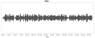

I am working on a graph of Voltage vs Current. I have my y axis (current scale) set to log and i want to change the scale to the format 10e-2 (for example). Everytime I try to do this, the graph scale to 1e-1. I need the scale to be in the notaion 10e not 1e. Can anyone hlep with this?

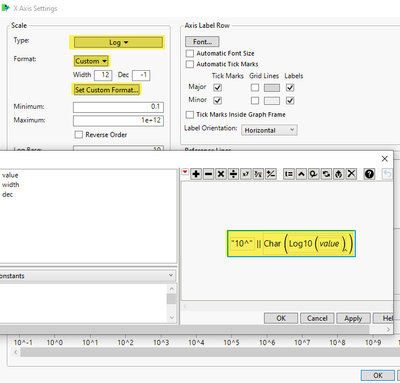

Good question because it took me a while to figure out how to do that interactively too. If you type the upper bar character '|' in the formula editor you will first get the or symbol, then if you type it again you will get the concatenate operator '||'. Also, if you double click on the formula it will open a text editor where you can type the two upper bars.
