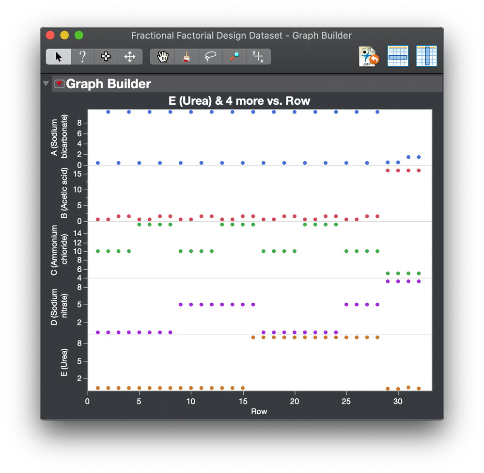

Adding to @txnelson and @statman , I plotted factor levels over the runs assuming that the order in the table is the order of the runs. I see a distinct pattern that suggests this experiment was not randomized.
The restriction on the randomization can dramatically affect the analysis. Regression of the linear model with a single error term (residuals) will inflate the type I errors of the hard to change factors and inflate the type II errors of the easy to change factors. It looks like you have five levels of randomization before the last four ad hoc treatments.
I also added column properties that facilitate the regression analysis of data from an experiment. JMP automatically adds these properties when you use JMP to design the experiment and make the table. You imported this data from an Excel workbook, which has no such properties.
I used Generalized Regression with Ridge regression to shrink the estimates and LASSO to select the parameters for a linear model with main effects and interaction effects, but if this experiment was not randomized, then I doubt any regression is valid.
