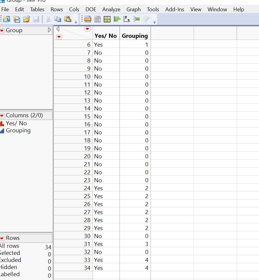

Hi,
I would like to group data as the attached image.
whenever there is a "No" the result will be a 0.
When ever there is a "Yes" the result will be a running number (1,2,3...) for each group.
How do I implement this in a formula (or script?).
Thank you very much.
Re: Grouping Data
Copy this expression and paste it into the Formula Editor for the Grouping column:
If(
	Row() == 1,
		temp = :Y == "Yes";
		temp;,
	:Y == "Yes" & Lag( :Y ) == "No",
		temp++;
		temp;,
	:Y == "Yes", temp,
	0
Change the name of Y to the original data column.

eldad_galili
Level III
Re: Grouping Data
Thank you very much :)
