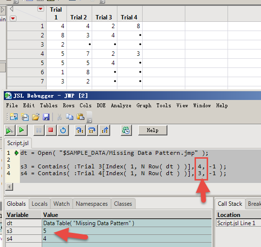

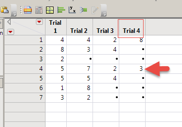

How do can find the number of non-null rows in the specified column?
For example:
dt = Open( "$SAMPLE_DATA/Data\Missing Data Pattern.jmp" );
the number of non-null rows in the "Trial 3" column of this table is 5,
and the number of non-null rows in the "Trial 4" column is 4.

lwx228
Level VIII
Re: How do can find the number of non-null rows in the specified column?
Thanks!
I'm not being precise here.
It should be:
The row number of the last non-null value in the "Trial 3" column is 5,
The row number of the last non-null value in the "Trial 4" column is 4.

lwx228
Level VIII
Thank Georg!
s4 = Max(
    !Is Missing( Column( 4 ) << get values() ) :* Transpose(
        1 :: N Items( !Is Missing( Column( 4 ) << get values() ) )
