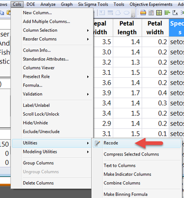

I would like to analyse a column with numerical/ordinal data in the range of 1-4. I can analyse the data using the x/y platform and all y is displayed by x variable values 1-4 in four analyses. However, I would like now to compare variable value 1 against all others (2-4) combined.
Despite intensive search in documentation and discussion forums, I have not found a way to do that and would appreciate any help. It seems that all the group by and merge features apply to variables, but not to actual values of a variable. Similarly, I would need a way e.g. to introduce age groups among ages in a column and analyse them separately by age stratum.
How can I group values of a variable for analysis ?

Re: Group values of a variable for analysis
Recode my be another option for you.  Recode groups 2-4 to the same variable name and save in a new column.  Based on what you have above stacking your data may also be an option.
First, thank you for your help!
Actually, recoding is the feature which I was looking for. It was however impossible for me to retrieve this information from any documentation or other source.
If you are using JMP 12 you can find Recode under Cols > Utilities > Recode.  Select the column you want to recode first and then go to the utility.
tz_1
Level I
Thank you, works fine.
