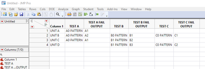

Example raw data:
 TEST ATEST A FAIL OUTPUTTEST BTEST B FAIL OUTPUTTEST CTEST C FAIL OUTPUT
UNIT AA0 PATTERNA1
UNIT BA0 PATTERNA2B0 PATTERNB1C0 PATTERNC1
UNIT CA0 PATTERNA1B1 PATTERNB2
UNIT D  B1 PATTERNB3C0 PATTERNC2

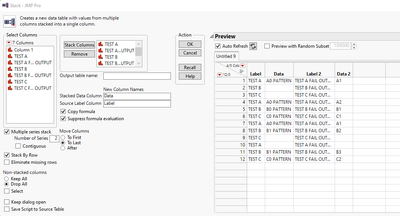

Go to Tables=>Stack
Fill out the Dialog Box as shown
Click on OK and it will give you the table as previewed

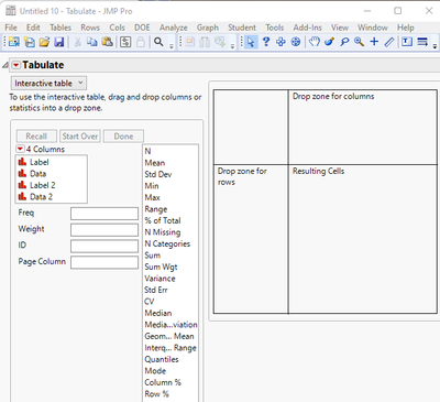

Now go to Analyze=>Tabulate
Drag the Data column to the Drop Zone for Rows
Drag the Data 2 to the far edge of the above dragged Data column and you will have the report you want

1) Your example data should have column headers before moving to JMP, assume First column is called "Part" in upper left cell
  "Copy", "Paste with Column headers" into a blank JMP data table
2) Execute the Table Operation "Stack"  (New in JMP 17, the preview window helps with real time feedback of potential output)
  • Select all Columns except "Part", press "stack columns" button to select six columns with test information to be stacked
  • Check "multiple series stack", set "number of series" to 2
  • De-select "Contiguous"
  • Check "Eliminate Missing Rows" (optional- it's easy to delete the non-failing test items later)
  • Optionally, for non-stacked columns you can "keep all" in case Part/Unit ID will be helpful for other analysis.
  • Press Ok

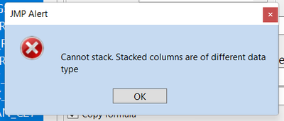

Thanks
I have tried it works on 3 or 4 pattern.
But when i include all my pattern column around 40++ with it output also around 40++. it will pop up this error.
I tried to make all my column to ordinal or nominal but not able to solve this one.
Any idea why it produce such error?
txnelson
Re: Group multiple column
If you change all of the columns to character, the stack will then work.
Jim
