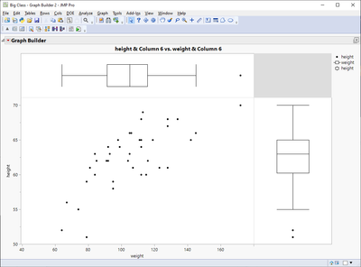

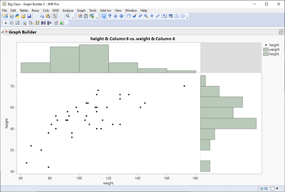

Re: Graphiques dans les marges d'un nuage de points
And this is what you can do in Graph Builder but to my knowledge you basically have to add placeholder columns as extra x- and y-axis

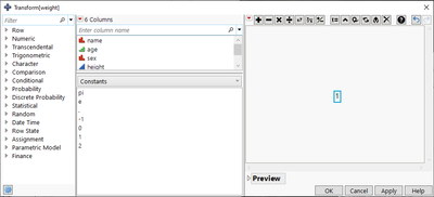

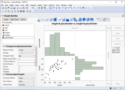

Add Nominal Transform Column to your Graph Builder with formula with just value 1 and rename if you want to
Add that new Nominal column as extra column to both X and Y Axis

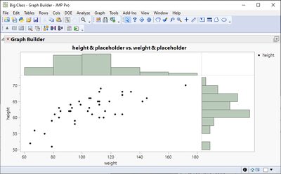

Disable plot (and other) plots for those placeholder graphs and add distribution for those. You can do this by holding ctrl+shift and clicking different plot types from corners
From the AXIS between different columns you can adjust the proportions
Cleanup the plot: edit those placeholder axis to hide labels, titles and legend items
