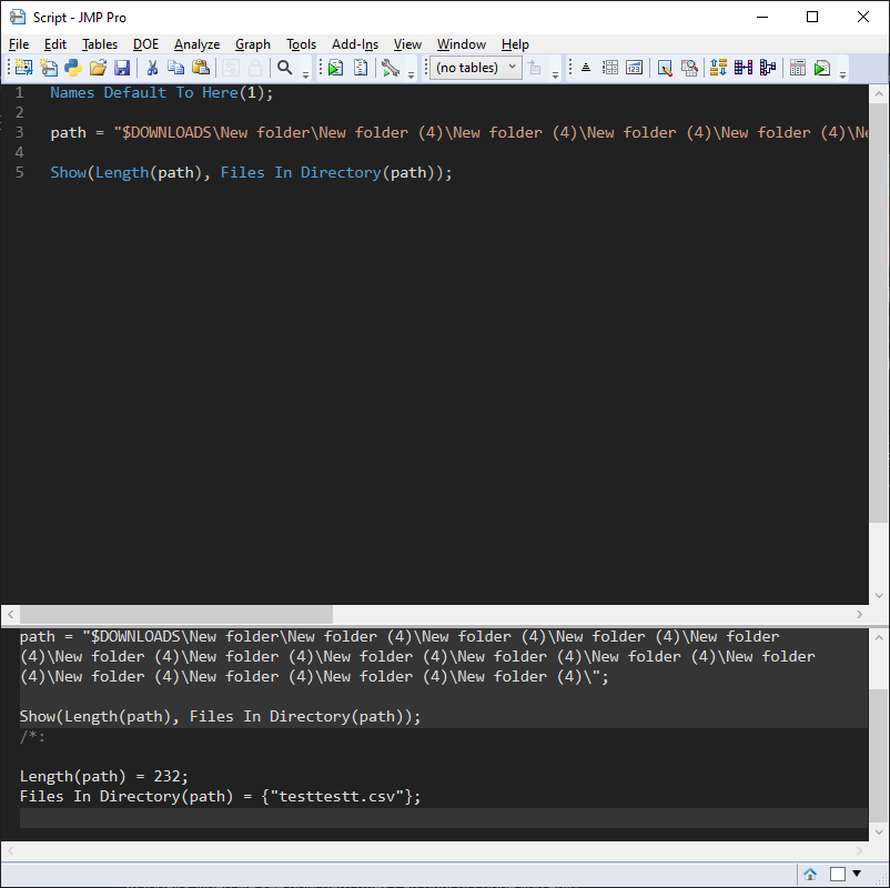

Names Default To Here(1);
path = "$DOWNLOADS\New folder\New folder (4)\New folder (4)\New folder (4)\New folder (4)\New folder (4)\New folder (4)\New folder (4)\New folder (4)\New folder (4)\New folder (4)\New folder (4)\New folder (4)\New folder (4)\New folder (4)\";
Show(Length(path), Files In Directory(path));
-Jarmo

Crazy :D Yeah I've already contacted them, they said I can just copy the directory to a place where the path is shorter and delete it afterwards
