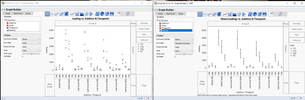

OK, first my boss wanted box plots, now it is too much, and instead I need to add the mean and std error bars... But JMP (14.0.0 64 bit windows 10) only wants to show one or the other:
How can I make JMP show both, with the mean point and std dev or std error bars overlayed With the points (other than combining them in photoshop or learning 'Graphpad Prism')?

Assuming you have a chart with just your data points being displayed,, all you have to do, is to right click on the graph, and add a second instance of Points, and set them to the mean and error bars.

Thanks! Exactly what I needed. I tried shift and control clicking the icons, moving a second instance of the reading all around, but that has now done the trick!
