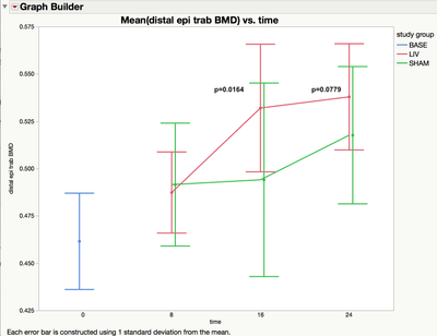

Hi,
I am plotting means of a response of three groups (BASE, LIV, SHAM) over time using graph builder.  So far I have been able to plot the means and STD, as you can see.
I would like to add p-values from a t-test comparing LIV vs. SHAM at each time point without having to do in manuallly by adding a text box to the image, similar to what I did here.
 Is this possible?
My current script is below:
Graph Builder(
	Size( 757, 640 ),
	Variables( X( :time ), Y( :distal epi trab BMD ), Overlay( :study group ) ),
	Elements(
		Points(
			X,
			Y,
			Legend( 46 ),
			Summary Statistic( "Mean" ),
			Error Bars( "Standard Deviation" )
		),Line( X, Y, Legend( 13 ) )

Here is a sample of how to add values to a Graph Builder output.  It isn't based upon your exact script, but I think you will be able to get from it the approach you will need to do to get your needs met.
Names Default To Here( 1 );
dt = Open( "$SAMPLE_DATA\Big Class.jmp" );
dt:height << set property(
	"spec limits",
	{LSL( 55 ), USL( 65 ), Show Limits( 1 )}
gb = Graph Builder(
	Size( 534, 448 ),
	Show Control Panel( 0 ),
	Variables( X( :sex ), Y( :height ) ),
	Elements( Points( X, Y, Legend( 5 ) ) ),
	SendToReport(
		Dispatch(
			"height",
			ScaleBox,
			{Add Ref Line( 58, "Solid", "Black", "MUSL", 1 )}
Report( gb )[FrameBox( 1 )] << Add Graphics Script(
Jim
