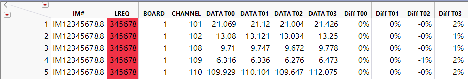

rmiyasato
Level II
Re: Color Cells With Missing Value and Greater Than Value
Hmmm... that's odd. The wong column gets highlighted. I've attached the script and csv. I do get an error saying that the column "Data" needs to be a character type. But I need it to be numeric for the calc.
Values in columns starting with Diff*** > .1 ==Red
Values in columns starting with Diff*** = missing values ==Red

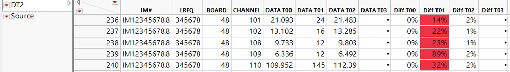

txnelson
There were 2 errors.....
1. I reversed the logic of the If() function I had specified....I had "!=" and it needs to be "==".
2. The colNames references in the color cells() had to reference the specific column....my error too
I have also cleaned up your code a bit......nothing major,
