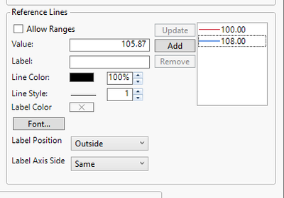

Hello everybody,
I would like to know if it is possible to define separated reference lines on the X axis when we have Y groups.
Here is an example using the BigClass data table.
I can define two reference lines, but I would like to display the red one only on the top graph and the blue one on the bottom graph.
Here is what I get:
Here is what I would like to get:
Is there a way to do that without playing with the menu Customize > Script ...?
Thanks in advance!

ian_jmp
Level X
Re: Graph Builder: reference line, different for each Y group
Graph Builder is designed to facilitate comparisons within and between groups. So, if you have multiple FrameBoxes from using grouping variables then, as you say, the x and y axes (and any reference lines associated with these) will always be common. So I believe the answer is 'no', not without resorting to JSL.

anne_sa
Level VI
Hi @hogi ,
That's a very nice way to answer the problem, thanks! But if I understand correctly, it works only if we want to highlight a summary statistic value (mean, median...) and not a user defined threshold?
hogi
Level XIII
The basic step is
Bar Style( "Float" )
It can also be used for user defined thresholds. Jus store it in a column and plot it as Bar chart with Bar Style("Float")
anne_sa
Level VI
Clear, thanks for your help @hogi !
