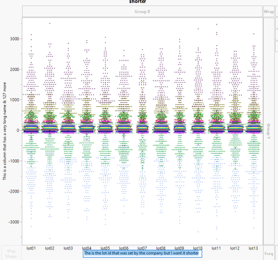

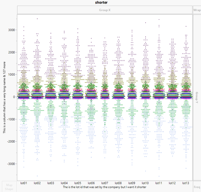

If the below is what you are talking about is the graph below, then all that has to be done is to double click on the axis title you want changed and then type in the new value
Jim

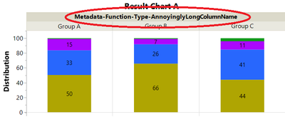

Thanks for your response! I am looking specifically for X Group. Here is an example:
Is there any way to change this without changing the column name directly?
