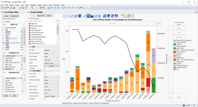

Hello community,
I come to you with a difficult question. Please see the image below for reference. I am using JMP 18, and I am trying to create a bar chart to show PPB values by quarter for various categories. The trouble I run into is that I want the category that has the highest total value from the chart to be on the bottom of the stack. For example, in the image below the category memory should be on the bottom of all the bar stacks followed by metal and so on. I know I can manually change the positions of these but that is where the complicated part of this question comes in.
From the image below you can see I have a local data filter where you can look at different technologies. Changing the different views drastically changes the total values for the overlay categories. I need a script that automatically reorders the overlay categories as I described before, every time the local data filter was changed.
I have been able to create a function that activates when the local data filter changes. I cannot figure out how to get the values of the categories that appear on the graph into some type of array so that I can create a custom order and then apply that to the graph. Does anyone know how to do this?
