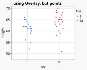

I just noticed that Graph Builder/BoxPlot has some problems with columns of modeling type Multiple Response.
this gets apparent if non-multiple-response entries are used.
In  plot 1, a male subset is showing up in the female group on the left.

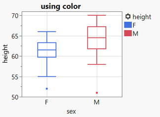

This is not the case if color is used instead of Overlay (second plot).

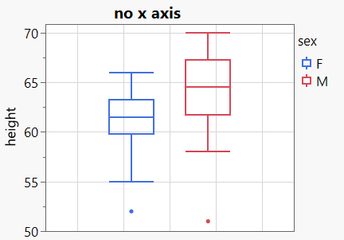

The wrong female plot looks like the 3rd plot -  where on the x axis no distinction is made between male and female.
Same issue if X and Y axis are interchanged.
Point plots are fine.
Plots  via Group X or Group Y are fine.

dt:sex << Set Modeling Type( "Multiple Response" ); Graph Builder( Show Control Panel( 0 ), Variables( X( :sex ), Y( :height ), Overlay( :sex ) ), Elements( Box Plot( X, Y, Legend( 5 ) ) ) ); Graph Builder( Show Control Panel( 0 ), Variables( X( :sex ), Y( :height ), Color( :sex ) ), Elements( Box Plot( X, Y, Legend( 5 ) ) ) ); Graph Builder( Show Control Panel( 0 ), Variables( Y( :height ), Overlay( :sex ) ), Elements( Box Plot( Y, Legend( 5 ) ) ) ); Graph Builder( Show Control Panel( 0 ), Variables( X( :sex ), Y( :height ), Overlay( :sex ) ), Elements( Points( X, Y, Legend( 6 ) ) ), );

.Yes, looks like a bug in the combination of box plot + MR x + MR overlay. Thanks for the nice example.
