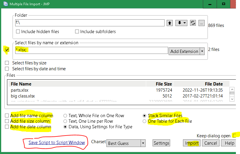

Craige_Hales
Re: How to import 30 Excel files without opening the data tables?
Take a look at Multiple File Import. MFI can load similar external files into a single JMP data table.
Import all the xlsx files from a directory.Import all the xlsx files from a directory.
You can save (and modify) the script to re-import again.
Craige
You must import data into a data table. I assume you want to avoid the tedium of opening and closing individual files. Have you tried the Multiple File Import feature?
