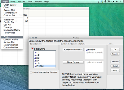

You can use the Simulator in the Profiler to generate this data for you.
Start by creating a data table with a column for each of your covariates.
Then create a column with a formula that simply sums those covariates. Really, this formula can be anything that references all of the covariate columns, we're only using this column to get to the Profiler. The example table attached here shows what I mean.
Launch the Profiler with your formula column.

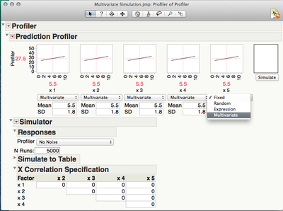

Then turn on the Simulator.

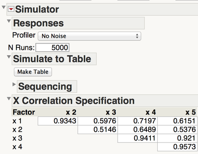

Set each of your covariates to Multivariate. Set the Mean and SD for each covariate, then in X Correlations Specification outline node you can enter the correlation coefficients.
Set the N Runs field to the number of rows you want to simulate and open the Simulate to Table node and click the Make Table button.

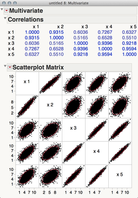

For my example here's a Scatterplot matrix for the simulated data.

Re: Generating random data based on correlation matrix
