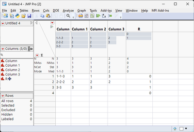

Doing the calculation from the original column is most likely easier
Names Default To Here(1);
dt = New Table("Untitled",
	Add Rows(3),
	Compress File When Saved(1),
	New Column("Column",
		Character,
		"Nominal",
		Set Values({"1-1-3", "2-2-2", "3-3", ""})
	New Column("Column 1", Character, "Nominal", Set Values({"1", "2", "3", ""})),
	New Column("Column 2", Character, "Nominal", Set Values({"1", "2", "3", ""})),
	New Column("Column 3", Character, "Nominal", Set Values({"3", "2", "", ""}))
dt << New Column("R", Numeric, Nominal, Formula(
	res = Associative Array(Words(:Column , "-")) << get keys;
	Remove From(res, Contains(res, "")); // remove missing value
	N Items(res) == 1;
Not sure how fully missing row should be taken into account, in this case it is treated as 0 but it can be changed to one modifying the final comparison
-Jarmo

jthi
Re: Formula
	Add Rows(3),
		Character,
		"Nominal",
	N Items(res) == 1;
-Jarmo
