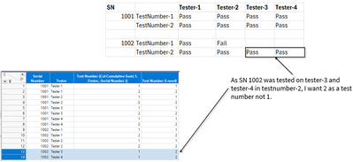

Add adjusted testnumber column.
I am not sure this is even possible. I do have test time stamp but they are not accurate.

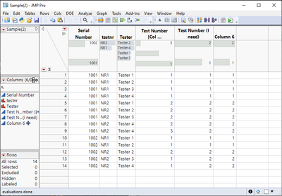

I like to add a test number column, but for the retested parts i want test number 2 not 1.

One option is to add testnumber to your data table, sort your data and utilize that
Col Cumulative Sum(If(Row() == Col Min(Row(), :testnr, :Serial Number), 1, 0), :Serial Number)

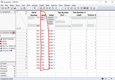

Re: Add adjusted testnumber column.
Thanks Jarmo,
How did you added Testnr column? manually?

I am talking about 'Testnr' Column. He used that in Column 6 formula.

I added it manually. We don't know what data you have available, so I assumed you would be able to access that as it was visible in your sheet which seems to be base for the JMP table.
Edit: It might be possible to add it as a formula but more information of the data might be required for that
