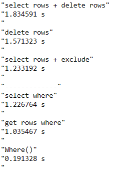

I wondered if deleting rows without selecting them is much faster:
dt << select rows(myRows) << delete rows();
dt << delete rows();
[actually, I wondered why the corresponding << exclude(myRows) is missing.]
So, here is another speed test:
Names Default to here(1);
get timing = Function( {myExpr},
	dt = New Table( "test", add rows( 10000000 ), New Column( "rnd", set each value( Random Integer( 1000 ) ) ) );
	myRows = Random Shuffle( Index( 1, N Rows() ) )[Index( 1, N Rows() / 2 )];
	t0 = HP Time();
	myExpr;
//print(n rows()); // same timing without this line
	If( N arg( myExpr ) > 2,
		Print( Char( Head( Arg( myExpr, 2 ) ) ) || " + " || Char( Head( Arg( myExpr, 3 ) ) ) ),
		Print( Char( Head( Arg( myExpr, 2 ) ) ) );
	Print( Char( (HP Time() - t0) / 1000000 ) || " s\!n" );
	Close( dt, noSave );
get timing( Expr( dt << select rows( myRows ) << delete rows ) );
get timing( Expr( dt << delete rows( myRows ) ) );
get timing( Expr( dt << select rows( myRows ) << exclude( 1 ) ) );
Print("-------------");
get timing( Expr( dt << select where( :rnd > 500 ) ) );
get timing( Expr( dt << get rows where( :rnd > 500 ) ) );
get timing( Expr( myRows = Where( dt, :rnd > 500 ) ) );
Print("_____________");
So,  deleting rows without selecting them is just marginally faster.
-> no wonder there is no corresponding function for Exclude.
