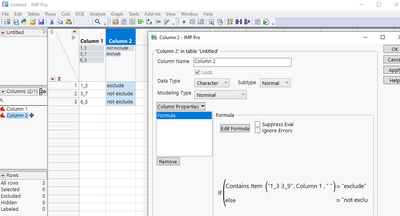

Usually in cases like this I tend to use Words() to split the string into a list and then compare using Contains() (or in some rare cases Contains Item()). But Contains Item() should also work and you just seem to have your parameters in incorrect order
New Table("Untitled",
Add Rows(3),
Compress File When Saved(1),
New Column("Column 1", Character, "Nominal", Set Values({"1_3", "3_7", "6_5"})),
New Column("Column 2",
Character,
"Nominal",
Formula(
If(Contains Item("1_3 3_9", :Column 1, " "),
"exclude",
"not exclude"
Set Selected

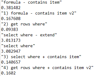

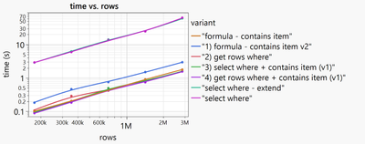

I did some timing tests comparing Jarmo's solution compared to my solution, and the Contains Item solution is spectacularly faster than the Select Where solution.

Jarmo found my problem -- switching the list and item in my formula. Thanks for the bit of code illustrating the correct usage.

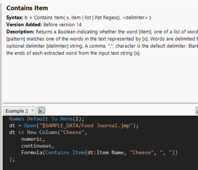

re: "Documentation a bit lacking" I concur. The instructions and example in the scripting index do seem a little ambiguous to me. Here is the entry for the scripting index:
Returns a Boolean that indicates whether the word (item), one of a list of words (list), or pattern (pattern) matches one of the words in the text represented by x. Words are delimited by the characters in the optional quoted delimiter (delimiter) string. A comma is the default delimiter. Blanks are trimmed from the ends of each extracted word from the input text string (x).
So (to my simplistic reading) either x or the {list} could contain the words to be searched or the list of words to compare it with. A few more examples showing some alternatives that included a Column as in Jarmo's example might help clarify.
