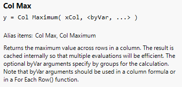

Re: How do I use the Col Maximum Formula with a "where" condition
See Help > Scripting Index > Functions:
Hi Mark,
Can you give an example on how to use the <byVar> when using col Max?
thanks.
I could add this formula to a new column in the Big Class example data table:
Col Max( :weight, :age )
