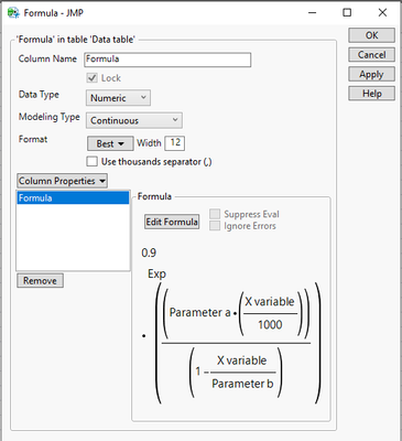

I would like to use a column including a formula option for plotting it in the graphbuilder window.
Nevertheless, it only works when all the parameters are included in the formula (the two following pictures).

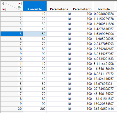

When I try to make my formula “flexible” with a link to other columns for adapting the formula, it doesn’t work.

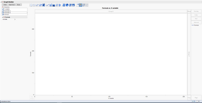

I got the following plot when I click on points (first picture) and no plot when I click on the formula option (second picture).

This happens because you try to plot a formula with 3 inputs vs. a single X-Axis.
The table shows that the 2nd and 3rd input is constant.
But Graph Builder doesn't know, because the parameters are not used in Graph Builder.

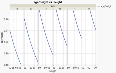

And this is the solution: Just put the parameters somewhere where they don't hurt (Group X/Y) - and you will get the curve ...
Names Default to Here(1);
dt << New Column( "age/height",	Formula( :age / :height ));
 dt << Graph Builder(
	Variables( X( :height ), Y( :"age/height"n ), Group X( :age ) ),
	Elements( Formula( X, Y, Legend( 11 ) ) )
