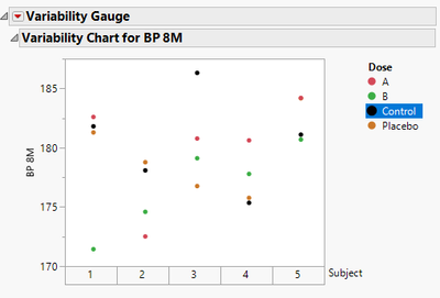

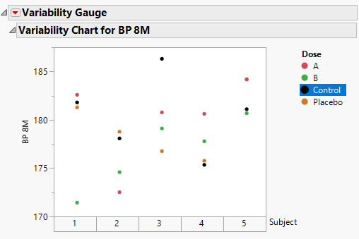

Hi all,
I am trying to fix the coloring of my variability chart. I create the variability chart and then use the row legend to create a legend for the column dose. I am trying to color the label "control" the color black through JSL code. How is this possible. I have tried many combinations but my JMP 16 doesn't seem to color anything differently. Any help would be appreciated to get it like the picture attached. Below is the code I have tried out. Thanks!
dt = Open("$SAMPLE_DATA/Blood Pressure.jmp");
vc = Variability Chart( Y( :BP 8M ), X( :Subject ), Show Range Bars( 0 ), Show Cell Means( 0 ), Std Dev Chart( 0 ), SendToReport( Dispatch( {"Variability Chart for BP 8M"}, "Variability Chart", FrameBox, {Row Legend( Dose, Color( 1 ), Color Theme( "JMP Default" ), Marker( 0 ), Marker Theme( "" ), Continuous Scale( 0 ), Reverse Scale( 0 ), Excluded Rows( 0 ) /*Custom Colors( {{"Control", RGB Color(0,0,0)}} )*/ )} ) ) ); vc << Legend( Color(1), Color Theme("JMP Default"), Customize( 1, {Row Label("Control"), Text Color(RGB Color(0,0,0))} ) );image.pngimage.png

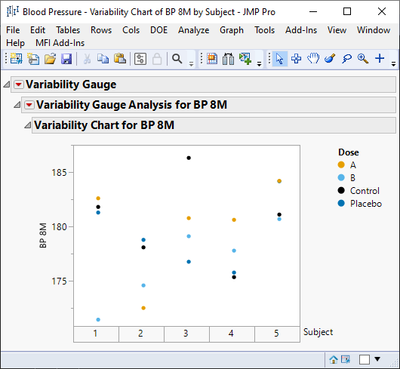

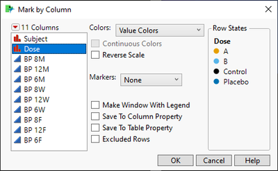

I'm fairly sure JMP can script this for you BUT you might have to create mock-up data depending if you might have more categories in the future as the Value Colors property isn't set by theme but by colors.
Names Default To Here(1);
Column(dt, "Dose") << Set Property(
	"Value Colors",
	{"A" = -13912408, "B" = -4042310, "Control" = 0, "Placebo" = -13400361}
varchart = dt << Variability Chart(
	Y(:BP 8M),
	Model("Main Effect"),
	X(:Subject),
	SendToReport(
		Dispatch(
			{"Variability Gauge Analysis for BP 8M", "Variability Chart for BP 8M"},
			FrameBox,
			{Row Legend(
				Dose,
				Color(1),
				Color Theme(""), // JMP seems to leave this "" when using Value Colors
				Marker(0),
				Marker Theme(""),
				Continuous Scale(0),
				Reverse Scale(0),
				Excluded Rows(0)
-Jarmo

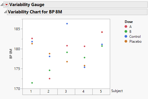

I think row legends are very non-customizable. You could try using Value Colors Column Property and then use that with Row Legend
