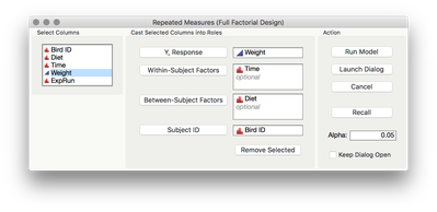

You can run this model in standard JMP by using Analyze > Fit Model. Setting up the model effects will be easier using my add-in, which it sounds like you already have (https://community.jmp.com/t5/JMP-Add-Ins/Full-Factorial-Repeated-Measures-ANOVA-Add-In/ta-p/23904). I've attached a data set with the format the data need to be in. dataset.png
You'll see that I have included a column for the experimental run, but we won't be using it when we set up the model. If you were interested in seeing whether there is evidence for differences between the experiments you did a few months apart you could use that column as a between-subject effect (it's between-subjects in the same way that diet is between-subjects -- no single bird is measured at both levels of the factor).
To set up the model using my add-in, we'll use Bird ID as the subject ID, Diet as a between-subject effect, time as a within-subject effect (and be sure that this column is marked as nominal), and weight as your Y. model.png
 This will return a linear mixed effects model equivalent to a standard repeated measures ANOVA.

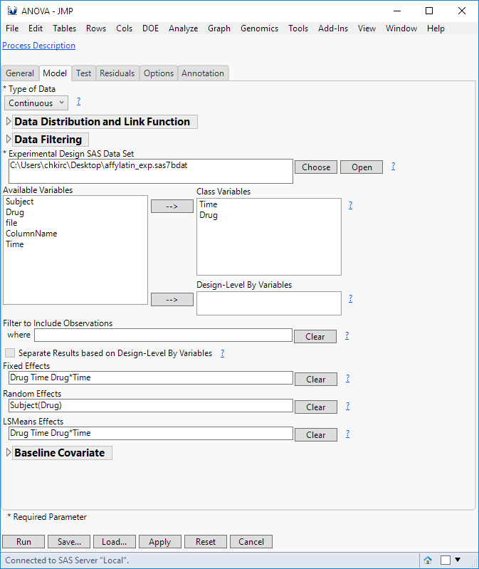

This can be done in JMP Genomics using the Fixed and Random effects seciton within the ANOVA dialog under Model tab (assuming that is what you are using). One is allowed to nest variables just like JMP is able to. Syntax is the similar, () instead of [], but one has to type them in instead of dragging and droping. Check out the below link and look at the Univariate Approach for the syntax of defining how the suject effect will be nested withing the between subject effect (drug). This would go into the random section, the rest are fixed effects and go into the Fixed Effects section.
http://www.jmp.com/support/notes/30/584.html
So in for this example, it would look something like this in JMP Genomics ANOVA dialog:
