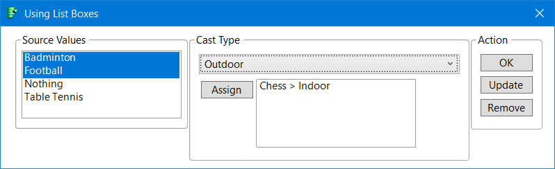

gzmorgan0
Super User (Alumni)
Re: Dynamic Dialog box for selecting different observations
@Rajat,
Attached is a modified script. Items to note:
  • Uses a ComboBox for the list of Category options, set by a list internal to the script.
  • Assigments are made by selections from the source list, the current category in the ComboBox and pressing the Assign button
  • The assignment is listed as Game name > Category
  • An Update button was added so that the table can be updated incrementally
  • The source list is created only for Games that have not been assigned a Game Type
  • The actions for remove and writing to the table had to be changed. Now the items in lb1, the assigment ListBox, have 2 pieces of information in a singe string. The Word(n,string,delimiter) function is used to exatract the pertinent information.
The screenshot displays that one assignment has been made. For this view, if the user presses assign, Badminton and Football will be assigned as Outdoor.
This interface reduces the number of variables for display boxes.  Creating a useful interface requires understanding the application, needs and usage, knowing some basics or finding example code that is close to what you want and understanding that. Note that there are many alternatives to this script.  Good luck!
JSL for the dialog layout. Full script is attached.
//--Dialog
usr = New Window("Using List Boxes", <<Modal,
	HListBox(
		PanelBox("Source Values",
		 slb = ListBox(wkList)
		PanelBox("Cast Type",
		 LineUpBox(ncol(1),
		    cb = ComboBox(catOpt, <<set width(300), _currCat = cb << GetSelected() ),
			lineupBox(ncol(2),
				bb1 = ButtonBox("Assign", <<setFunction(gSelect) ),
				lb1 = ListBox(catList, nlines(nl) )
		PanelBox("Action",
		   LineupBox(ncol(1),
		   bbok  = ButtonBox("OK", onOK),
		   bbupd = ButtonBox("Update", onUpd),
		   bbrmv = ButtonBox("Remove", onRmv)
