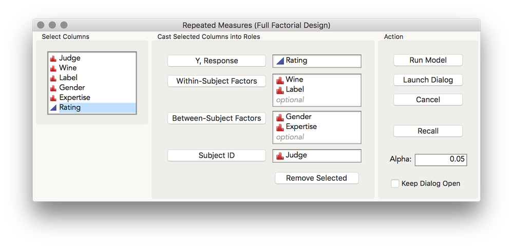

Usage:
Cast columns into the appropriate role and click "Run Model," or click "Launch Dialog" to proceed to the Fit Model dialog to make changes to the model before running. To keep dialog box open after running, check the box for "Keep Dialog Open."
Note: For these models, "Subject ID" should have a Nominal modeling type; this add-in will automatically set the modeling type to Nominal if it is not already.

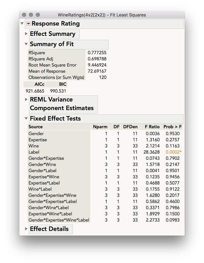

Model terms are generated, and an Fit Model output is launched with Summary of Fit details and Information Criteria, REML Variance Component Estimates, Fixed Effect Tests, and Effect Details.
Screen Shot 2017-02-14 at 11.16.18 AM.pngIn this case (with two within-subject factors, and two-between subject factors), the model generated is as follows:

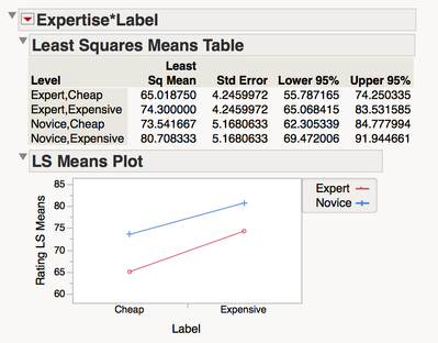

Many options are available under the top-most Red Triangle, including additional regression reports, parameter estimates, diagnostic plots and saving residuals, leverage pairs, etc.

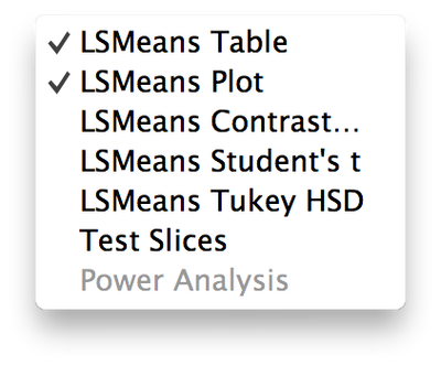

Plots, Means, and Tests
Expand Effect Details to generate plots for individual factors and interactions, and to perform tests on the cell means using all pairwise T-tests, Tukey HSD, and linear contrasts.

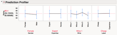

7604_Screen Shot 2014-11-23 at 3.06.13 PM.png7596_Screen Shot 2014-11-23 at 2.21.08 PM.png
To interatively profile the model, select the top-most Red Triangle > Factor Profiling > Profiler

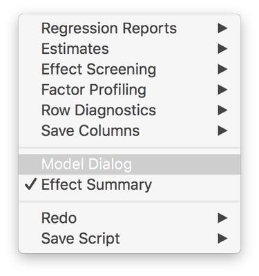

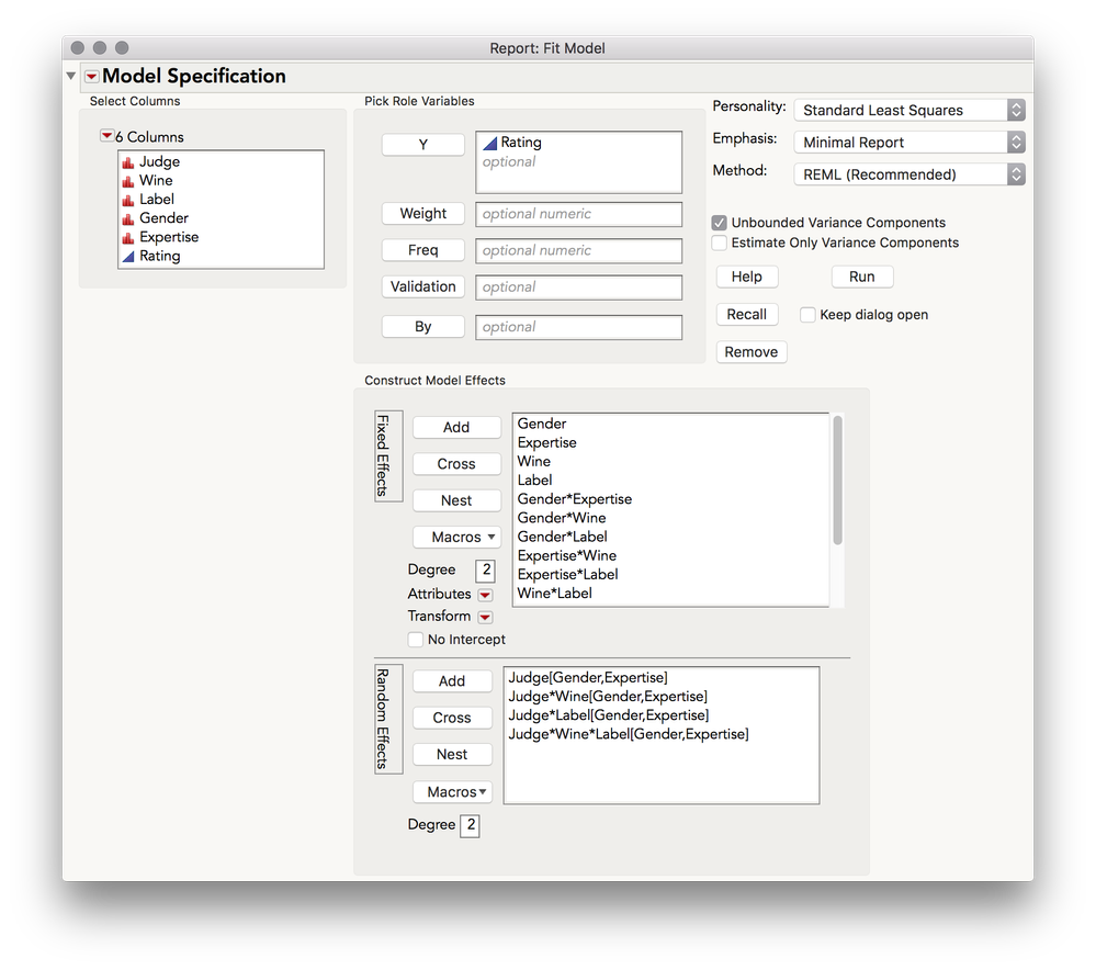

Modify and View Model
Select the top-most Red Triangle, and select Model Dialog to see the model specification and to make changes to the model.

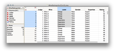

 Data format
This add-in requires that data be in tall, or long format. This is when repeated observations from a subject are represented across rows, rather than across columns (see below).
If you need to restructure wide data, use Tables > Stack, and cast the columns with repeated observations in to the Stack Columns section. For factorial designs you will need to separate out the factor levels of each factor. By using Col > Recode this can be done quickly.

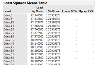

Thanks Julian.
Yes, you are correct. I am trying to look at the differences between the time points per treatment. However, when click on the red triangle of the trial*time box under effect details box to run the analysis, it seems none of the options are highlighted. I am able to run further analysis under the Trial and Subject boxes, individually. Please see the picture if that makes sense:
julian
This will happen if either time, trial, or both are marked as continuous in your dataset. All should be marked as nominal for this add-in and type of analysis to estimate the mean, and difference in means among treatment, at the different time points.
By the way, is Trial an alias for Treatment or did you mean to have Treatment in your model rather than trial?
jxa014
Yes, Trial and Treatments are interchangeable. In my model, there are 3 treatments/trials. I changed the trials and time to both nominal. Is it normal for the output to not give the upper and lower 95% CI when you do this change?
julian
If you are missing those confidence intervals I suspect you also received other errors when trying to fit the model. From the number of levels you have for Time I suspect you don't have enough degrees of freedom to fit the model using time as nominal-- I expected you had measured individuals on far fewer time points. Given the number of levels you have it seems you would be better off modeling time as a continuous effect -- that is, estimating a slope between Y and time for each condition rather than means for Y at each time point for each condition (which is what treating time as nominal is doing, and is thus expensive in terms of parameters estimated).  This is not something my add-in is built to do -- the model you're trying to fit is one in which you're nesting random coefficients, something you can do with the dedicated Mixed Model personality in Fit Model in JMP Pro. Here's the documentation page on that:
Launch the Mixed Model Personality
Sorry my add-in wasn't able to help you with this analysis!
Julian
jxa014
Julian,
I think you are right on multiple accounts. The time in my study is continuous (0-120min; 5 min increments) as well as the df. I am doing preliminary analysis and we only have an n of 4, so more subjects are needed. However, now I know the process for the 2 way anova plug in.
Thanks for your help!
