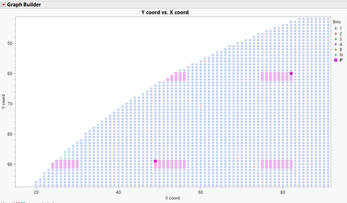

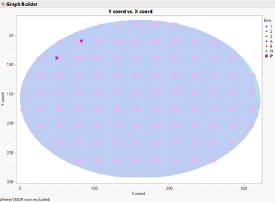

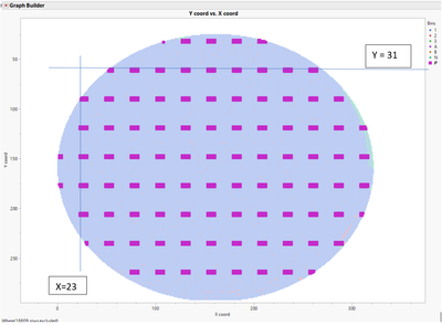

Hello JMP Community,
I am trying to figure out a way to identify the X and Y coordinates of the highlighted rows.
Get the lower x boundary of those bin "P" lying furthest to the left, that have at least SOME of their left edge on the wafer.
And get the upper y boundary of those bin "P" lying furthest to the top, that have at least SOME of their top edge on the wafer.
In this example the X = 23 and Y = 31. I would to get these values using some formula or calculation
I've attached the data table below.
Jackie__1-1686665220379.pngJackie__1-1686665220379.png      Jackie__0-1686665065279.pngJackie__0-1686665065279.png
I would really appreciate any suggestions
