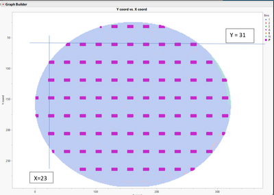

Hello JMP Community,
I am trying to figure out a way to identify the X and Y coordinates of the highlighted rows.
Get the lower x boundary of those bin "P" lying furthest to the left, that have at least SOME of their left edge on the wafer.
And get the upper y boundary of those bin "P" lying furthest to the top, that have at least SOME of their top edge on the wafer.
In this example the X = 23 and Y = 31. I would to get these values using some formula or calculation
I've attached the data table below.
I would really appreciate any suggestions
Thanks,
Jackie

I highlighted row just for the reference. I want to identify the 2nd most lower x boundary of those bin "P" lying furthest to the left and the 2nd most top y boundary. I don't think what you suggested is what I am looking for

@Jackie_ , in these cases, you can easily identify these "P" bins by their coordinates.  In your example, your 2nd most top y boundary has values at, or close to Y = 31, and your 2nd left most boundary has values at, or close to X = 23. Making some type of list, or AA may help you quickly compare these values. Including these values in an AA with the row number an other valuable information that you're looking for could satisfy your request.

Is this a geometry question about whether an item at X,Y lies on the edge of a circle of radius R? Then, if CX,CY is the center,
radius = sqrt((x-cx)^2 + (y-cy)^2)
radius < R inside
radius > R outside
and you are just left with issues about the size of the item at X,Y and if X,Y is the center or top-left of that item.
Craige

Starting to understand, maybe. x==23 and y==31 is a corner on a rectangular set of bins. That corner that is completely beyond the circle. The bin below, and the bin to the right, is at least partly within the circle?
There is some step size for the bins in both x and y. there is some radius for the circle. you want to determine the 23 and 31 value?
If that's correct, I'll suggest a brute force algorithm that tests bins in a loop, looking for one that satisfies the requirement.
Craige

@Craige_Hales Yes, I want to determine the 23 and 31 value. Can you share an example code? Fairley new to this
Craige_Hales
Re: Finding X and Y coordinate
brute force, just test every bin. You'll want to adjust something, but this is the idea.

The for-loops look complicated just to center the bins on the circle. I don't know what the real rule is.
I'm a bit unclear on the rule that will make exactly one selection.I'm a bit unclear on the rule that will make exactly one selection.
