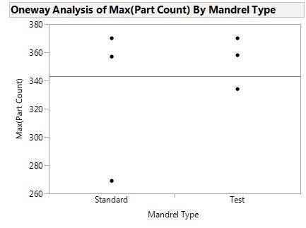

I am doing some analysis with data that is in error. However, when I exclude it, I still want it to show on the graph for some different reasons. I know this should be very simple, but I am having a hard time finding any pointers on how to do this. Any help would be greatly appreciated.

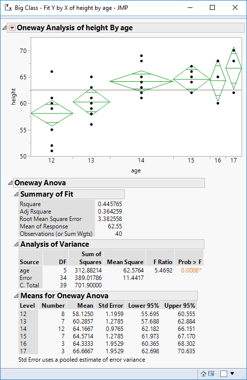

Using Big Class example again. Using Oneway platform like you with height versus age and ANOVA.

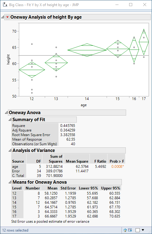

I enable Automatic Recalc feature and then I select rows with age = 14 and hide them.

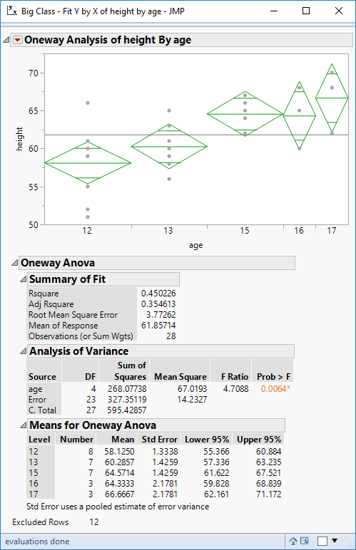

The data disappear from the plot but all of the ANOVA results remain as they were. Now unhide and exclude the selected rows where age = 14.
The selected rows reappear but the ANOVA results change.

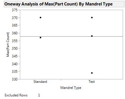

Re: Exclude and Show Data in Fit Y by X and Graph Builder
When I use Fit Y by X, even with just graphing, I get the following: Figure 1 (excluding point) and Figure 2 (including point). As far as I am aware, there are no calculations involved
