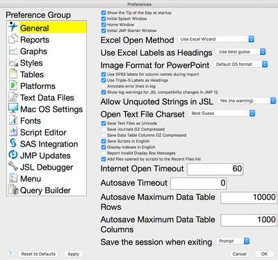

Hi Paul,
Use SPSS labels for column names should be the default when opening the file directly from within JMP.
Can you check your preferences to ensure the display SPSS labels check box is enabled?
JMP-->Preferences-->General
USE SPSS LABELS FOR COLUMN NAMESUSE SPSS LABELS FOR COLUMN NAMES

Hi Stan,
That's great, thank you. It works just fine for one of the files. For the other (less than half the size) file, I get an error "insufficient error to open file." I understand from some googling that may be to do with long string names. But in any case, that's not necessarily the main issue.
I actually downloaded separate files for the World Values Survey, the JMP ones and the SPSS ones, so I shouldn't actually need to import; indeed, if there's a way, I'd just like to know how to display SAS JMP labels in such a way that they're visible without accessing column info.
Is that possible? Again, the picture in my original post should help.
