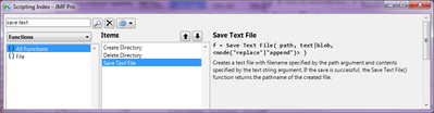

My suggestion would be to use the "Append" qualifier on the Save Text File.
This will allow you to populate the output file on an ongoing basis
Jim
