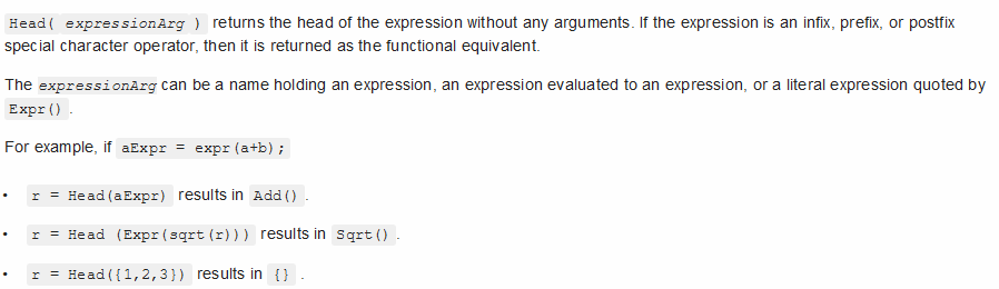

From , I learned that there are some functions which evaluate their argument and others which don't:
I wondered about Head. Here everything looks logic ...
f= Expr(x=2);
Substitute(NameExpr(f),Expr(x), Expr(y));
Head(f);
Head is not like Substitute, I can directly use the function name as an argument  - and Head returns the head of the expression: Assign()
After checking some other functions which "don't evaluate their argument":
Expr(x=2); // x=2
Name Expr(x=2); // x=2
let's check the result for
Head(x=2)
which is "2" - i.e. the result after evaluating the argument?!?! why is it not assign()?

jthi
Re: Does Head evaluate it's argument?
Names Default To Here(1);
{a, b, c} = {1, 2, 3};
Head(Expr(Sum(a, b, c)));
HeadExpr(Sum(a, b, c)); // Deprecated
Head(Sum(a, b, c));
https://www.jmp.com/support/help/en/17.2/#page/jmp/advanced-expressions-macros-and-lists.shtml#
-Jarmo
hogi
Level XIII
ah, ok, the scripting index is very clear.

hogi
Level XIII
@hogi wrote:
the argument gets evaluated (1x, like with Name Expr() )
sorry:
Head():
means:  "the expressionArg can be
1) a name holding an expression - and Head will use the expression,
2) an expression - and Head will evaluate it and will use the result as input
3) or a literal expression quoted by Expr() - and Head will take the literal expression".
Name Expr():
1) a name holding an expression - and Name Expr will use the expression,
2) an expression - and Name Expr will take the expression".
Name Expr(1+2); // 1 + 2
Head(1+2); // 3
