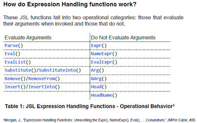

From , I learned that there are some functions which evaluate their argument and others which don't:
I wondered about Head. Here everything looks logic ...

Head is not like Substitute, I can directly use the function name as an argument  - and Head returns the head of the expression: Assign()
After checking some other functions which "don't evaluate their argument":
Expr(x=2); // x=2
Name Expr(x=2); // x=2
let's check the result for
Head(x=2)
which is "2" - i.e. the result after evaluating the argument?!?! why is it not assign()?
