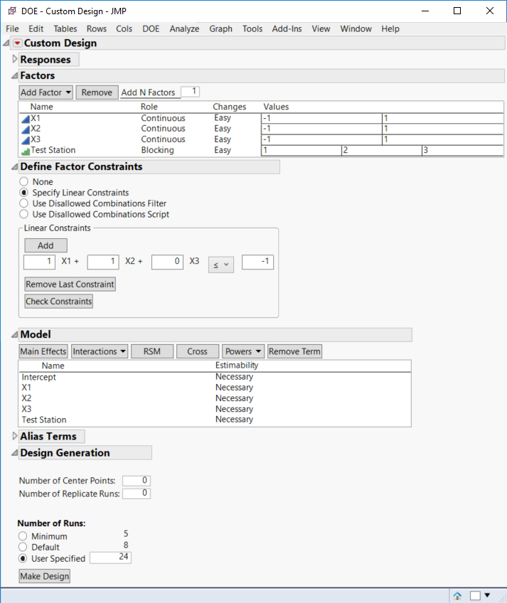

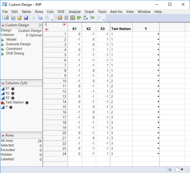

To illustrate my idea (not necessary validate it), I created a simple example with three continuous factors but you could have more factors and of different types. There is a linear constraint involving X1 and X2. The model is simple first order but could be any linear combination. I am going to perform eight runs at each of three test stations for a total of twenty-four runs. The specifications in the Custom Design look like this:
Then I click Make Design and finally Make Table. The resulting design is:
Hopefully you can adapt the approach to the specific details of your experiment.

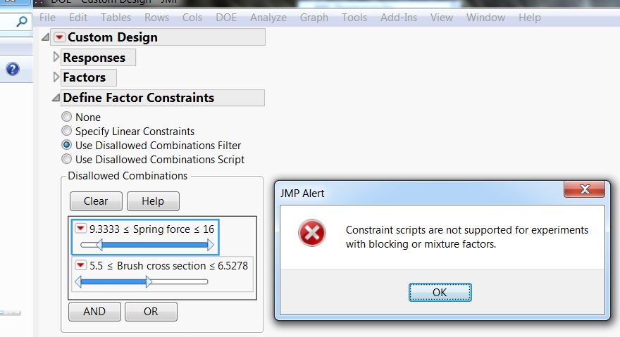

I followed your instruction and it worked. But  with me, it does not work to run with "Use Disallowed Combination Filter" See underneath.
DOE - Custom Design - JMP_2017-11-27_17-35-23.jpgDOE - Custom Design - JMP_2017-11-27_17-35-23.jpg
could you please check wether your system is doing it with "Use Disallowed Combination Filter" .

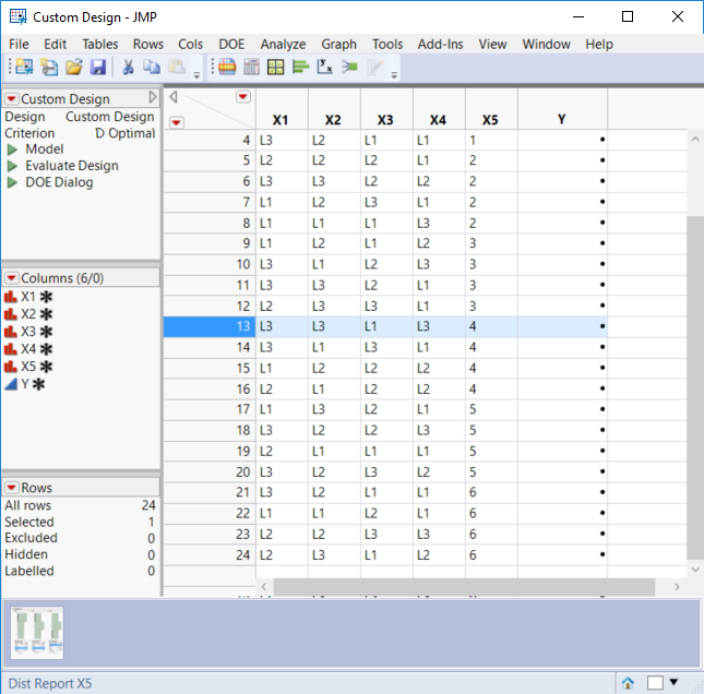

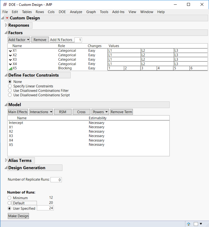

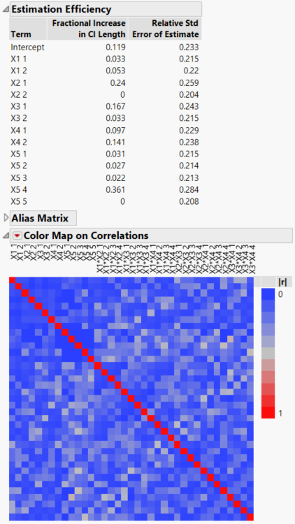

Here is another example to illustrate the idea I suggested. I created a custom design for 4 categorical factors, each with 3 levels. I add a blocking factor with block size of 4 runs, the maximum number of runs per tester. I do not specify any constraints on the factor combinations. I am only using the first order model for this example. I want 20 runs in the final design but there are 4 combinations that I want to avoid, any or all of which might appear. I specify a total of 20 + 4 = 24 runs. Here is the specification so far:
I click Make Design and Make Table and then examine the results to identify the disallowed combinations. Perhaps X1, X2, and X4 cannot all be at level 3, so I select it before deleting it:

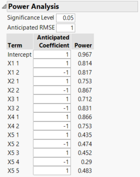

I can now evaluate the results by selecting DOE > Design Diagnostics > Evaluate Design. Assuming that this design is the initial study, the emphasis is on estimating and testing model parameters so the Power Analysis, Estimation Efficiency, and Correlations would be of informative:
Separately, would you please explain the disallowed combination that you defined above as [ (9.3333 <= Spring force <= 16) AND (5.5 <= Brush CS <= 6.5278) ]? Perhaps it could be specified as a linear constraint.

here in this screen dump, I have added senseless constraints, just to show: as soon as I add a constraint I will get the failure message shown.
Did you get a failure message as well after changing from "specify linear constraints" to "Use dissallowed combination Filter" and click make table?
