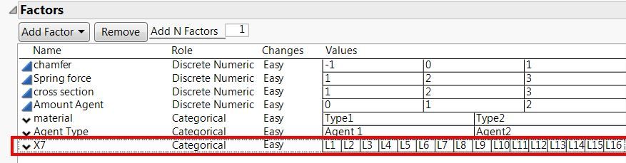

Sorry my impression is we deviating from my question. Let me raise my originally question again. What is the difference between.
Blocking Factor with 16 Blocks or Categorical Factor with 16 Levels. See underneath. Sure, making Amout of levels equally and adding just a main effect for the categorical value.
DOE - Custom Design - JMP_2017-11-29_08-50-21.jpgDOE - Custom Design - JMP_2017-11-29_08-50-21.jpg
DOE - Custom Design 2 - JMP_2017-11-29_08-59-16.jpgDOE - Custom Design 2 - JMP_2017-11-29_08-59-16.jpg
You answered above: "It is a common misconception that a blocking factor (blocks have fixed effects on the response) is just another categorical factor but they are much more than that. They represent a constraint on the experimental unit (part of the experimental run but generally not explicitly part of the design except for blocking)".
What does it mean? What causes the difference? What is the failure I have to expect if I choose an optimal design with a categorical Value instead of Blocking?
Many thanks
Peter
Re: DoE with Blocking and Constraints
The purpose of a categorical factor is to model its fixed effects (estimate and test). The purpose of a blocking factor is to provide a homogeneous group of runs based on the inclusion of an external variable (e.g., tester) in the design. The homogeneity provides for estimation or comparison without the additional variation from changing the blocks. Full randomization of the runs across blocks would not necessarily provide the best set of treatments in each block. Full randomization occurs with a categorical factor.
You would not include this variable if you only needed one level, but you have 16 levels out of convenience or necessity. You are not interested in the effect of the blocks but you want the groups to be homogeneous and you want to be able to account for their variance.
