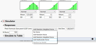

Re: Disappearance of confidence intervals on profiler
@Dan_Obermiller
For accounting for noise of input variables, I see this Random by Model is greyed out.
Do you also have troubleshoot for this?
Maybe. The model error comes from the Root Mean Square Error (RMSE) of the model. So in that model fitting window go to the red triangle for the model and choose Regression Reports > Summary of Fit. Is there a non-zero number in the RMSE field? Also, that menu choice is only available from the Fit Model platform. I don't believe you get that option from the Graph > Profiler option because that is not a model fitting platform.
Dan Obermiller
BJK_JerseyBoy
Level III
Thank you @Dan_Obermiller
Indeed, this option is available only in Fit Model platform.
Thank you for your help again!
