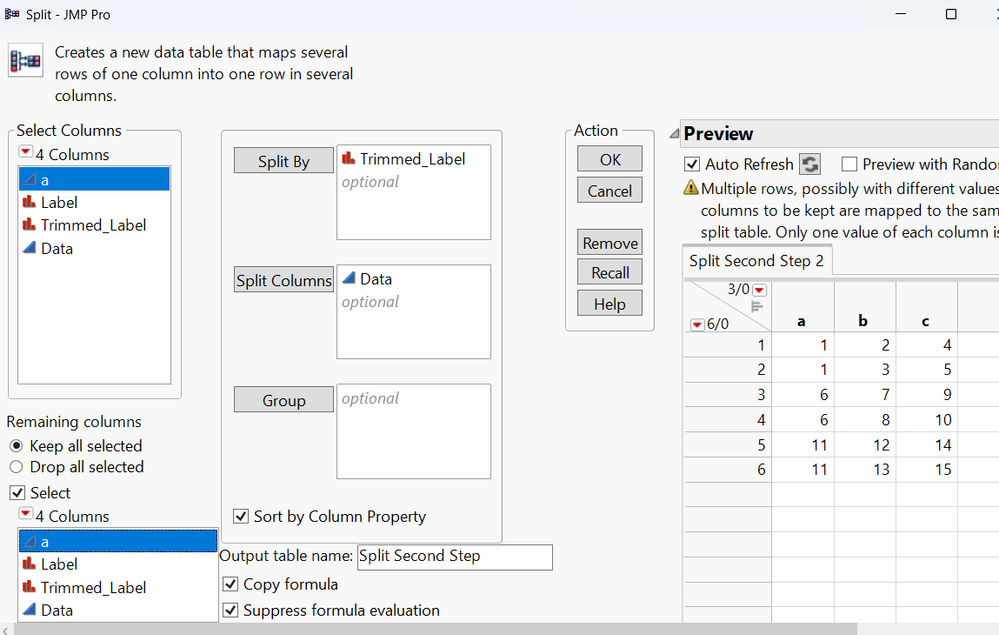

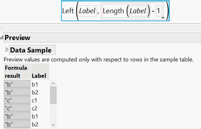

If the lowest character will always be 1/2 (or at least indicate the column family that should be stacked), this can be done in two table operations and a formula.  These steps could be scripted or captured in workflow builder if the actions need to be repeatable.
Add formula column to trim "Label", excluding lowest character
Table "Split" Data by Trimmed Label....

Re: Stack Columns with multiple names
wow, nice link between multiple-series stack and stack + split !
