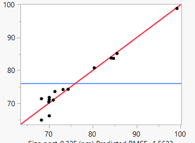

1. I built a customized response surface model with triplicates in the central point.
When I open the 'Profiler' from 'Fit model', it shows confidence intervals as shown below.
However, when I open this fitted model through 'Profiler' under 'Graph' tab, it does not show confidence intervals.
I also do not show CI in 'Actual by Predicted Plot'.
Do you know what might have caused this and how to fix this issue?
